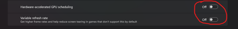

Hello, for me, disabling these two settings in Windows 11 worked.
Go to: Settings -> System -> Display -> Graphics -> Advanced graphics settings, and turn off these two settings: Hardware-accelerated GPU scheduling and Variable refresh rate
Also, you can try disabling them one by one.
