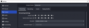

We'll also need screenshots of your Advanced Audio Properties, and Settings->Output->Streaming tab.

you only have spoti in the vod audio track enabled
on Track 6 you must enable all sources you would hear in the VOD

I'm a bit confused on this. The "Twitch VOD Track" selection allows you to select a track. I specifically selected Track 1 and had my game audio going to Track 1 (without a doubt). But, no audio at all showed up in the VOD. I was using Track 2 for the "Audio" selection meant to be heard on the live stream.
Is it hardcoded to Track 6 or something?

Just tested track 6, and it seems to bring the audio into the VOD. If this is the case that Track 6 is hardcoded for the VOD, why is there a selection at all? Should it not just explain to use track 6 instead of giving a selection?
What sources are in the track you choose for VOD depends on what audio sources you assign to that track in Edit->Advanced audio settings. It seems you didn't assign the correct audio sources to your track 1.
