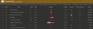

Step 2: Create a New Tampermonkey Script​
  1. Open Tampermonkey:
    • After installing Tampermonkey, click on its icon in the Firefox toolbar.
    • Select Create a new script.
      click on the + and a new Script will appaer
  2. Add the JavaScript Code:
    • Delete all the Default Information first -
    • Below insert the full Tampermonkey script. It listens for OBS WebSocket events
      and pauses or resumes video elements (or other actions) accordingly
      and then Copy & Paste the Script
    • Step 3: Save and Activate the Script​
      1. Save the Script:
        • Once you've pasted the script, click on File > Save in the Tampermonkey editor.
      2. Adjust the @match Directive:
