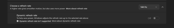

i sadly dont have a 120z option for my monitor, i looked in both nvidia control panel and the windows settings.. the only other option i have is 60hz
also which drive? the C:?
