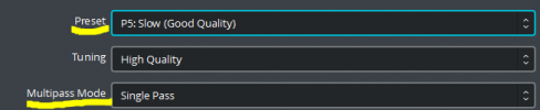

I want to ask about these two settings:
- Preset
- Multipass mode
I use NVENC and Preset P5: Slow (Good Quality) and for Multipass I use Single Pass.
What are the correct settings for streaming? Is there anything we should be guided by when choosing these options?
Is it a big diference betwenn P5 Slow Good Quality and P7 Slowest Best Quality when it comes to computer load (usage) during the stream?

P5-P7 are close in performance. The difference in quality between them is also not significant and is only a few percent (depending on the content). Up to 2K resolution (Inclusive) you can use P7.

Multi pass mode
In 1-pass rate control modes, the encoder will estimate the required QP for the macroblock and immediately encode the macroblock.
In 2-pass rate control modes, NVENC estimates the complexity of the frame to be encoded and determines bit distribution across the frame in the first pass. In the second pass, NVENC encodes macroblocks in the frame using the distribution determined in the first pass. 2-pass rate control modes can distribute the bits more optimally within the frame and can reach closer to the target bitrate, especially for CBR encoding.
  • none
    1pass mode. (fast)
  • 2pass-quarter
    Runs first pass in quater resolution, which results in larger motion vectors being caught and fed as hints to second pass.
  • 2pass-full
    Runs first pass in full resolution, slower but generating better statistics for the second pass.
I would recommend using 2pass-quarter. This is the best option.
Not all cards support that. For the ones that don't, OBS waits for the last moment to give you a cryptic error popup. The log has the complete error message, which tells you the real problem, but the popup cuts off the useful part.
2pass-full often works in that case, as it says in the log but not the popup.
