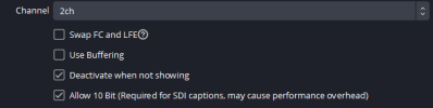

Hi Norihiro! I don't know if anyone has the same problem as me, but I have a couple of docks called “FTDock” and FTDock-1” that are linked to the Face Tracker plugin that I can't remove from my dock list on OBS. I wanted to know if you had a solution for me.
I know I created them by clicking on “New Face Dock...” in the OBS tools menu. But I can't find the option to remove them from the list of available docks in the OBS menu.
Thanks for your help!
