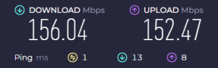

1.) Internet Speed :
1770817284766-png.118285

Ohkay, so up to what bitrate should I set mine to which can be handled by my internet? Also I am not getting an option for setting it to 2560x1440. My monitor is only FHD 1920x1080 60hz. Could that be the reason for it?
