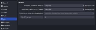

Jacon
Also some of my OBS setting rn
rockbottom
You need to reduce load, plain & simple. Run your monitor @ 60 or 120HZ. Reduce game quality, cap frame-rates, remove java script errors, ect.

Game quality already reduced, framerate capped. Don't know about Java script error and how to remove it.
The outpur resolution in video can be also an issue?
