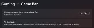

yes its needed because i record on steam recording beta at lossless quality on my gaming pc's 3080 ti, if i were to stream on it while recording lossless quality it would use alot of resources, plus i dont want a i9 9900k and 2080 ti just sitting on the ground behind wasting away so figured i would find a use for it by setting up a streaming pc.
i will start a little stream on the gaming pc just to post its logs here, other than that i will try to disable the stuff at the top and go again 12+ hours stream on streaming pc to see if the audio lags behind. It just sucks that this takes hours of streaming to see if the problem still happens.(just checked too game dvr and game bar are turned off on gaming pc but obs says its still on?)
Gaming pc log after 15 minute stream: https://obsproject.com/logs/CbmPFoBXxvd1UQhX
also ive done countless tests over the months of my i9 9900k vs 2080 ti at p7 with different settings and no matter what i see the cpu encoding produces better quality at 7k bitrate(reason why i want 2pc setup)
