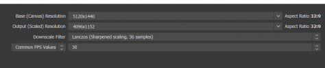

I've attached pictures of my current settings.

Your output resolution should relate to the resolution your "audience" will most likely be viewing your stream on from their device. Do you think your audience is watching from a 4096x1152 screen? Only you can answer that question for yourself. My question is provided as a way to help you analyze your own situation.
Also check out this thread about the Lanczos downscale filter to decide if it is the best choice for your stream > https://obsproject.com/forum/threads/which-downscale-filter-to-use.125517/

The problem is your monitor resolution and how your video is displayed to users with a 16:9 monitor and so on.
