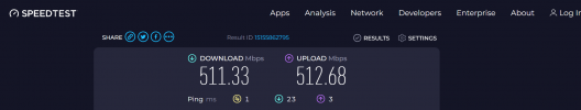

Basically just checking if OBS is dropping frames or not and using the latency counter that the game provides. But I'd be willing to use some specific program to do it if you can point some out. It is my pc and it's the only pc on the house, it's cable connected and wifi I limit wifi to use only 15% of the bandwidth on our smartphones
What have you done to test sustained upload speed, to YT in your case or elsewhere (to confirm ISP isn't the issue... which it usually isn't)?
Just the usual speed test. I tried to find some long upload tests websites but I couldn't. You know a good one?
